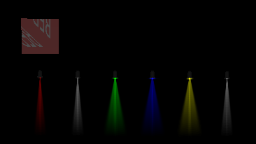

I am attempting to use a picture panel, but the picture I upload is skewed and distorted. What are the requirements for using the picture panel.
I have attached a screen shot of what I am describing, plus the picture I am trying to use.

3D View
3D View
3d View.PNG (14 KiB) Viewed 5523 times

Re: Picture Panel
Try to rotate the Picture panel 180°. It seems textures coordinates are ok only on one face.
