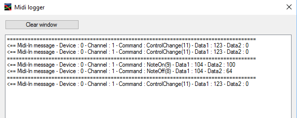

Here's a screen shot of a section of the log with the NoteOn, Note Off commands.

Here is a screen shot of the log. The screen shot two posts up is also of the same example and also shows the button state after the NoteOff Command.
I disabled the timecode sync to make the commands easier to see.
In this example the button stayed selected after the NoteOff command.
Midi Log of single button press for duration of 1/4 note.
Capture (1).PNG (11.44 KiB) Viewed 16194 times
Thanks!
Re: Midi does not disable buttons with Control set to "Fader
With the "NoteOff" message, Data2 must be at value 0.
