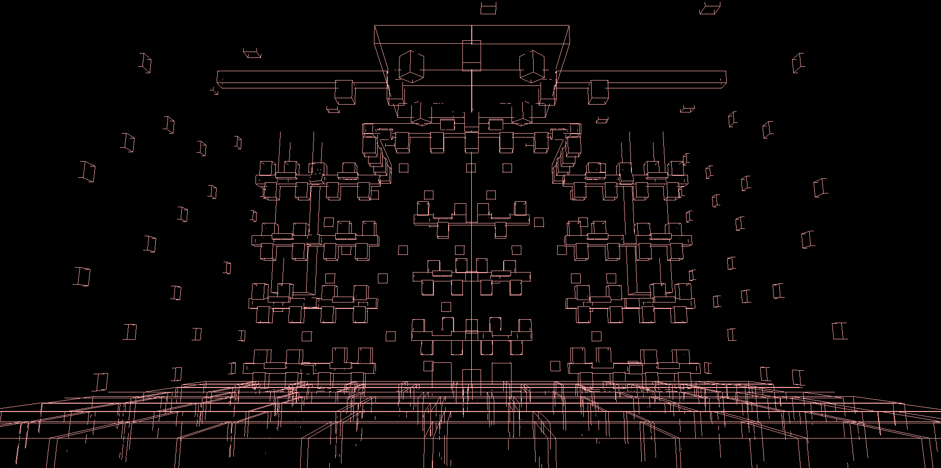

The stage was initially destinated to another lightshow (that has been currently paused) and designed with the intent of using at full the DMX universes (unlimited budget as usual hahaha).
The first universe is entirely dedicated to the control of 100 RGB spheres (500 channels), that I placed on the walls and ceiling of the stage. This is the first time for me using RGB spheres in such a massive way, and I'm happy with the nice "uplifting" they can display.
The second universe is almost entirely dedicated (504 channels used) to manage all hanged beam fixtures on the main trusses.
The third universe is definitely the fullest, with all 512 utilised to control multiple fixtures types. In this universe are present:
- the beam fixtures located on the ground around the artist and directly above the stage;
- the lighting located in a circular truss rigged on the ceiling (that I didn't utilized in this show);
- 15 strobes
- the LED blinders
The fourth universe (at 507 channels) hosts all the washlights and the "alternate" set of beam fixtures (the ones placed in pairs on the upper side of the trusses).
The lightshow is entirely timecoded and prepared in V9.
For the scenery, hidden behind the trusses there are two PA clusters and additional equipment is placed on the ground.
There are 88 "crowd" units, each is composed of 5 people: the audience is then made of 440 people. The new 3DView has good performances considering the quite intense use of wash and gobos in some sequences.
Highlighting the models and the fixture on stage.
TheCube - obj and fixtures.png (37.4 KiB) Viewed 41012 times
