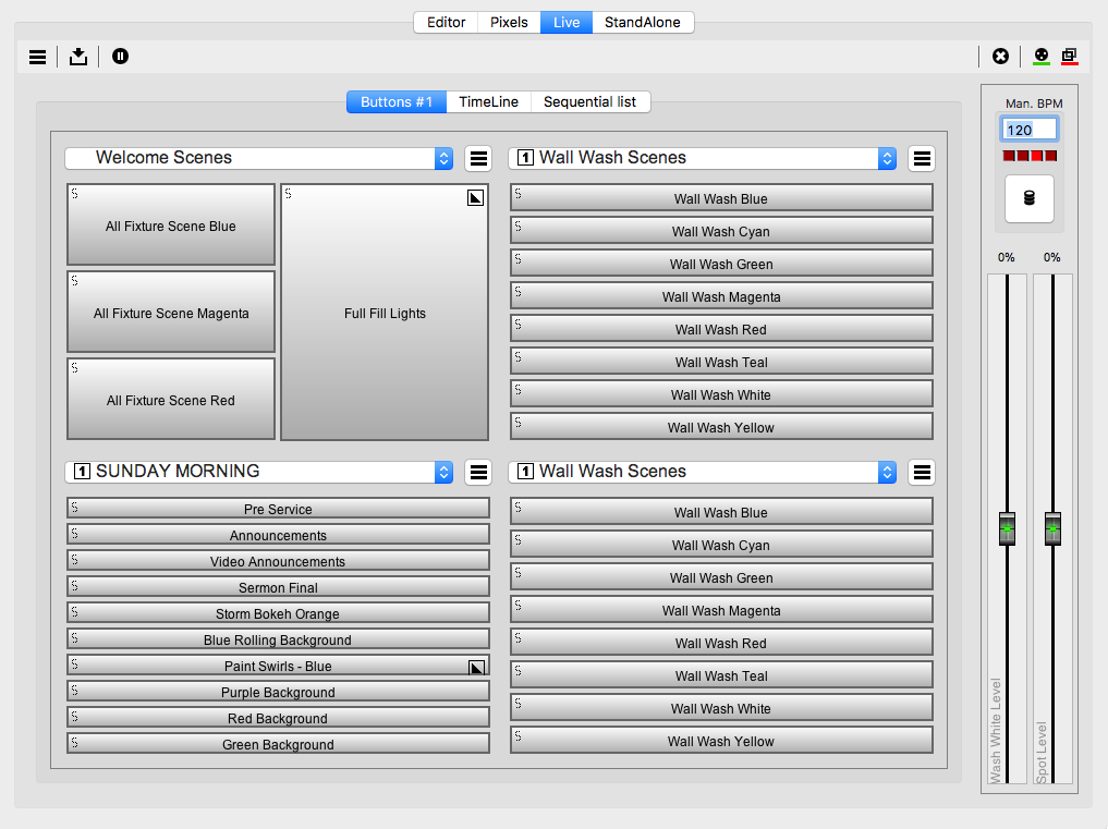

Here is a picture of your lightshow (V8.1.29 under MacOS Sierra).
What shall we do to get the crash ?
- lightshow.png (94.47 KiB) Viewed 24704 times

Push any of the scene buttons in the bottom left hand corner for an undetermined amount of time. Sometimes as quick as 7minutes. Sometimes as long as 4 hours. Crashes have taken place using any of this buttons.
However, I should point out that I am not using V8.1.29 under Sierra. I'm running 8.1.00 under El Captain because the newer versions have either collapsed or don't launch the MIDI triggers. It can learn them, but won't launch them.

The crash "after long time using" is known ; it is fixed since V8.1.21 (viewtopic.php?f=10&t=4521&start=10#p18507).
We are able to trigger the buttons "Sermon final", "Pre Service" and "Video announcements" with some buttons of our APC mini midi device.
Sorry but we are not able to reproduce any crash (or midi problem) with V8.1.29.
