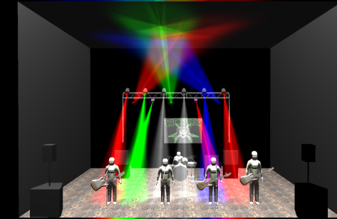

Shows that I have some things working, just not the head tilt.  Panning works
All lights on_front1.png (107.66 KiB) Viewed 39842 times

Once I select the 3d icon, by the dmx icon, the lights that are hanging down immediately tilt up in the 3d window. After that I can't get any sequence of faders or fader settings to make it move again. As I mentioned before, panning works, no problem. But the head tilt does not. Is there a setting in the fixture or somewhere else that is wrong? Thanks for all your help. And I might still try a newer video card, to see if that helps.
