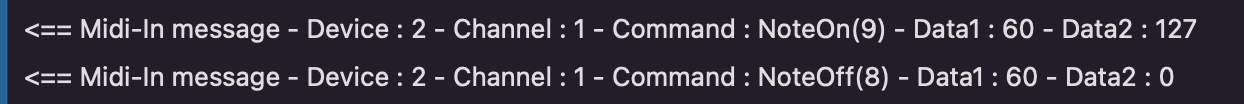

Re: Midi note off doesn't work with DMX channels patch
Post by tibellus »
See picture.
Thank you!
Done for next fix file
The fix is online.
(sorry for the delay)
