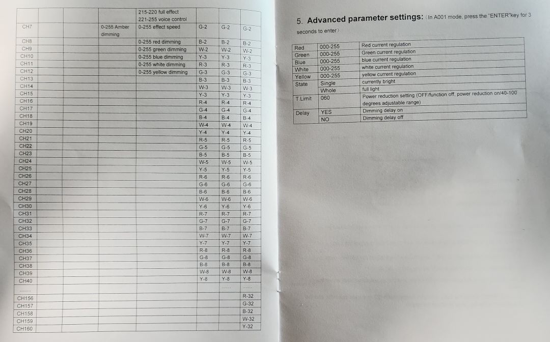

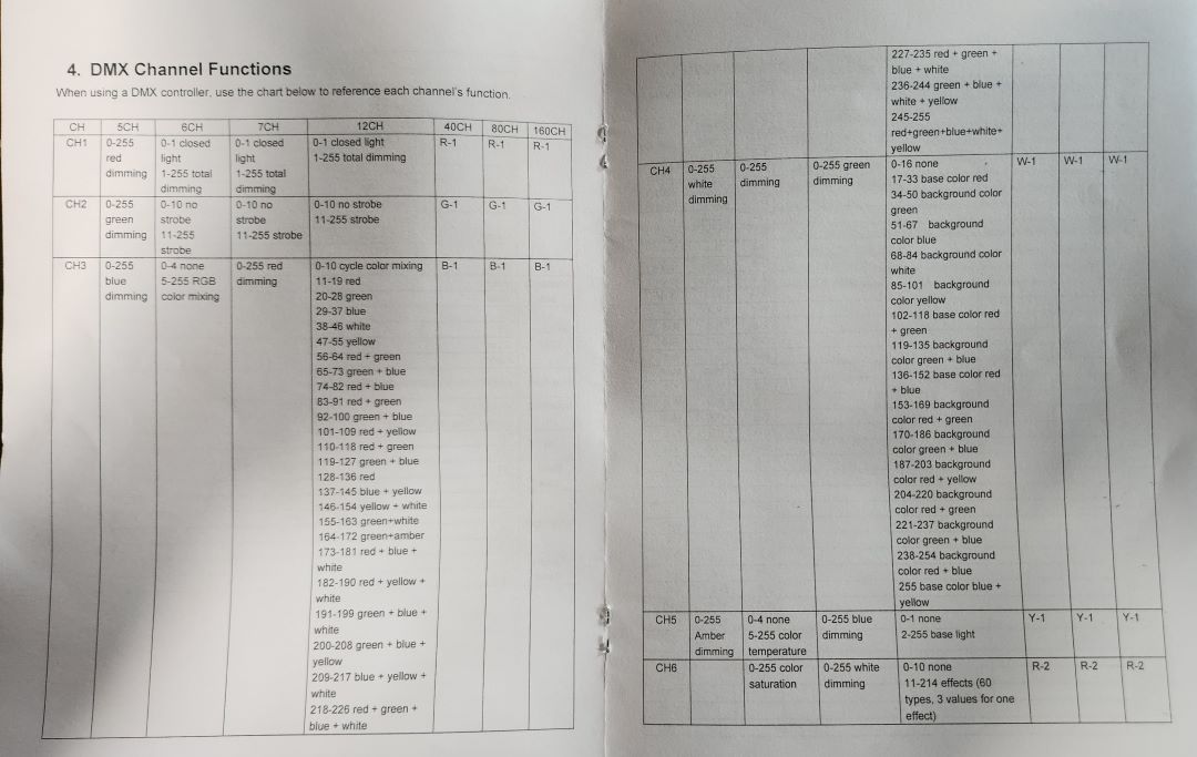

Hello , can you please please please help me with profiles for this led tube in 12 thru 160 channel mode, i got grey hairs already from this :S
Also all i have for CH list is 2 pics from the book it came with .
Thank you very much i hope you can help
