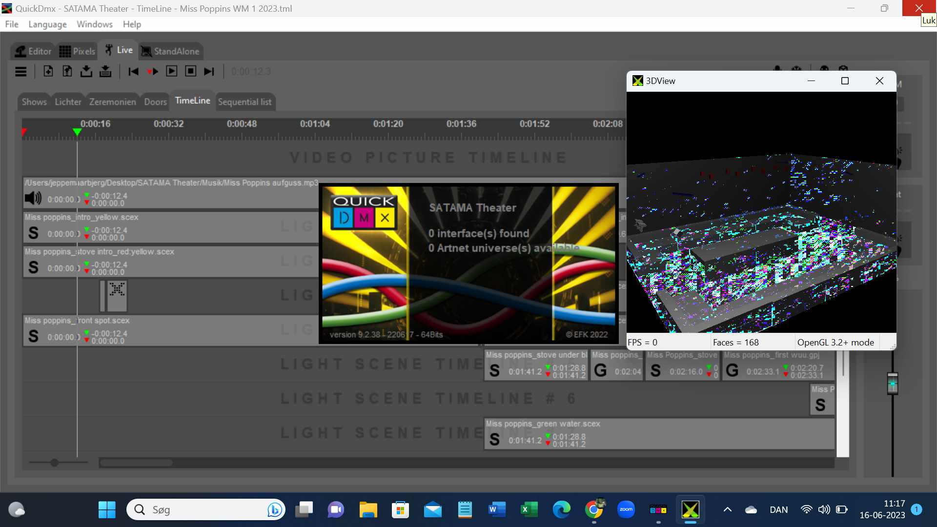

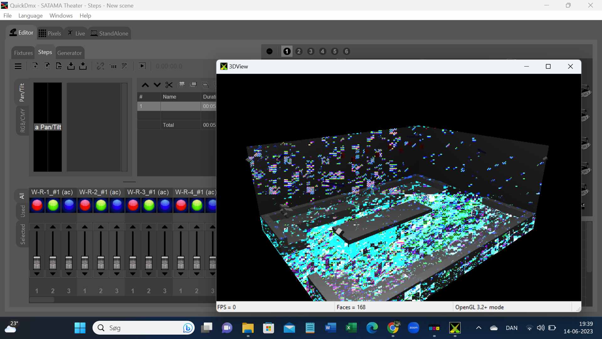

I have done that... And when I open it its pixelated.
Re: 3D view pixelated
Please post a link of a screenshot of your pixelated 3DView screen (https://forum.thelightingcontroller.com ... f=3&t=6904).
Please take a screenshot with the "About" opened too
merdam
Posts: 8
Joined: 13 June 2023, 20:46
Post by merdam »
i've attached two pictures...
