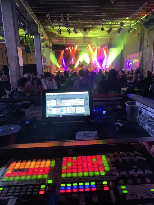

I use APC20/40 hybrid. 18 faders, plus crossfader. Plus 16+ knobs.
I’ve seen people do 3x APC20 in a row, which would get 27 fader
