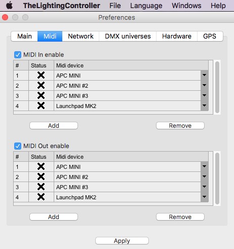

So it's possible to avoid that, but i'm still not sure what you mean by inverting them in the Midi Preferences of the software.
Do i have to uncheck the MDI In and Out enable boxes, click apply, and then check them again and click apply again?

Bonifacedj wrote: Do i have to uncheck the MDI In and Out enable boxes, click apply, and then check them again and click apply again?
Oh yes, that is what i have to do.
With all the hassle and confusion related to my weekly blackout i forgot asking this before and got the answer already...which i didn't remember yesterday morning.
Bonifacedj wrote: Then i un-checked the "MIDI In - MIDI Out enable" (see attachment) and pushed "Apply".
Then i checked them again and pushed "Apply" again and the confusion cleared up.
Good to know :roll:
Re: second AKAI APC mini [fixed]
In the Preferences, the number in the column "#" IS the *device* number you can see in the midi settings of each button. AFAIK, uncheking/checking enable boxes is not needed after changing something in the midi Preferences grid.
