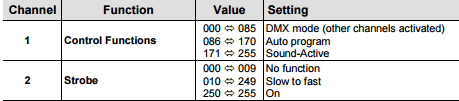

I recently purchased two Scorpion Duals. As I attempted the setup under ShowXpress 8.1.29 for Windows it did not change the patterns correctly. It seems the ShowXpress fixture config file has swapped the "Pattern Selection" and the "Strobe" functions. The printed manual is correct but does not align with ShowXpress as the functions are swapped. The layout as shown in the Steps configuration does not seem to be correct.

I checked the profile but found results that differ from yours. Please see the attached pictures of the profile included in software 8.1.29 [which is what i checked it on] and note that all channels are correct on my end. Please delete the software and reinstall it. Maybe that will help fix the issue.
