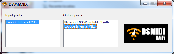

now you need the DSWifiMIDI server. downloadable at https://code.google.com/p/dsmi/download ... .zip&can=2&
install it and it looks like this

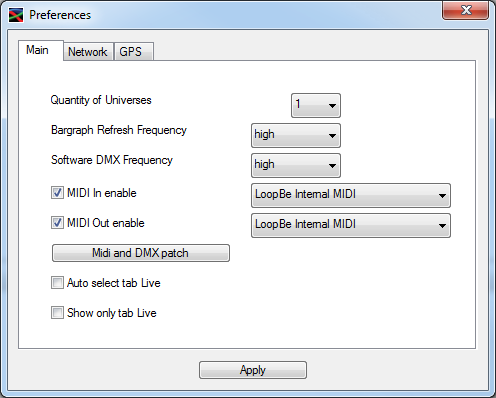

Select LoopBe Internal MIDI as input and output.
prefs sweetlight.png (31.43 KiB) Viewed 12691 times
