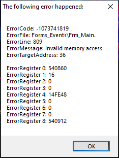

Sorry for the long layoff, but I'm finally getting back to solving this problem.
Here's the error message provided by the debugging console when the crash in question happens.

- Update your software with the latest fix file (v9.2.32 at this time)
I have, but none of the updates over the past year have had any impact
[image]
- Disable midi output from the main preferences (to isolate an infinite loopback problem)
Error took longer than usual to generate and came back with a new message
[image]
- Disable faders midi output in Live settings (only useful with motorized or lighted physical faders)
Error took longer than usual to generate and came back with an identical message to the previous fix
[image]

Sooo, onto your last fix suggestion:
- If possible, directly configure your midi device in the software instead of passing by a MIDI Translator (crashes can come from a buggy midi translator as already seen)
It's not possible until you either provide us more master faders or support multiple MIDI inputs to a single fader
That said, I started tinkering with Bome's to see if I could eliminate the issue by eliminating code.
1) Disabled the fader input commands coming from the Livid Base II (typically not the cause of the problem) - still crashed, but new error!
MIDI Fader Error - disabled LIVID input to fader.png (8.99 KiB) Viewed 12653 times
2) Disabled the fader output commands passing ShowXpress feedback to both the Livid Base II and Numark Orbit - back to the old error!
[image]
