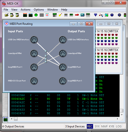

Done but it isn't easy to understand and to do.
Now I've a port merging the Midi In's and a port sending Midi to both Controllers.
But this doesn't make sense if Controller 1 uses the same commands as Controller 2.
I've seen that it's possible to create your own template for Launch Control :)
Please tell me:
Am I right that Midi-Ox and LoopMidi has to be started with Sweetlight?
How can I start the stored profile automatically?

Put the ports created by Loop MIDI in Windows Start menu... You want them to start automatically before starting up MIDI OX >SX I usually minimalize them after start up... Easy for Me... Hard for you? :lol:

In Windows menu under programs you will find the Startup folder, Drag Loop MIDI Icon into Startup folder... Port(s) should already be saved if you named them when creating them... Hope this helps!
In MIDI OX save Profile under file... I've never had to save the profile because MIDI OX recognizes devices if they are pluged in before booting up computer...

Loopmidi linked to Autostart - logical and done before your reply.
OX also linked to AS.
I'm very astonished that it starts with my stored *.ini file (Profile)
OK if it's working - nobody asks - The Essential: it's running
Thanks for the help
