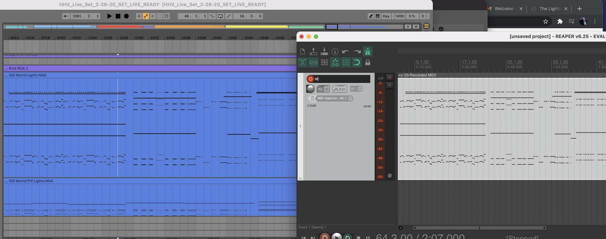

Hey there - I've been pulling my hair out trying to figure this out and use a similar setup, I use Ableton Live 10 to transmit midi to the native Mac OS IAC Controller, and then use that as the midi input device in ShowXpress 9.2.23. This was working previously and after a ton of time debugging - I was able to narrow it down to the ShowXpress not able to interpret more than one or two midi notes at a time - it would get the midi signal from the IAC driver and activate each scene/button individually if I triggered them in Ableton, however running the show with 3+ notes at a time would cause certain notes to intermittently stop working, or wouldn't receive the off event so buttons would get stuck. So I knew at least that the signal path was completing and activating the lights. I also used the midi logger in ShowXpress and noticed it was only getting certain notes from the IAC Driver when running, so I thought maybe it was an issue with the IAC driver. I then tested the IAC Driver by running Ableton midi through the Driver to Reaper and then I realized I wasn't losing any midi there - it was an exact match (see the attached image).
I am on Mac Big Sur 11.2.3, but this is a 2017 macbook pro with an Intel Core i7 CPU - not the M1. I don't believe the M1 is the cause.

- IAC Print from Ableton to Reaper
- Screen Shot 2021-03-11 at 3.16.55 PM.jpg (120.95 KiB) Viewed 14133 times
