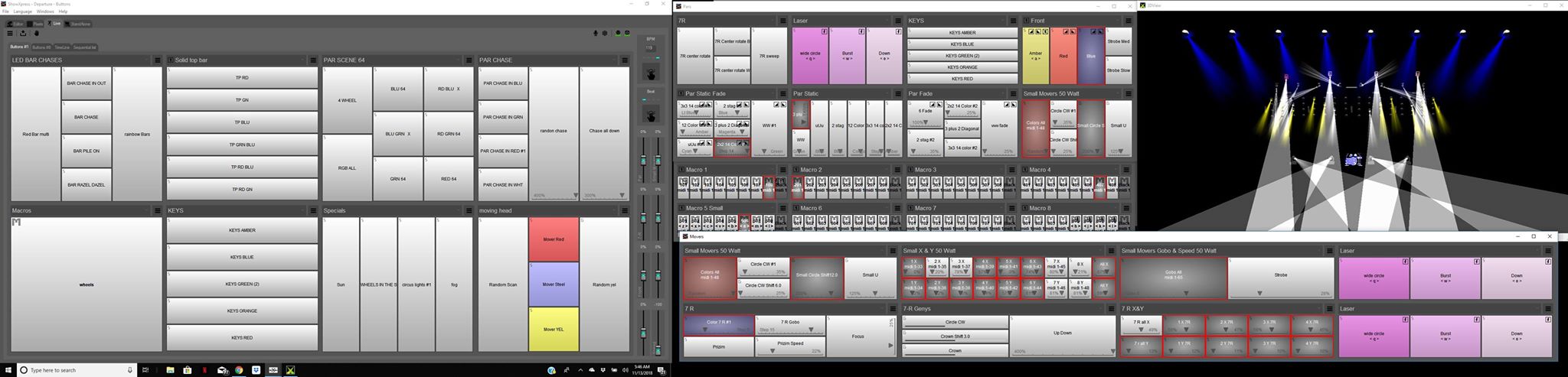

Earl,
I am just starting to get familiar with ShowXpress. It's so overwhelming but with all the help here, it's getting better. I am building my Live show and was feeling ok, until I saw yours!! It's amazing, I can't begin to understand how you did it!!! I was able to get some ideas based on your screenshot because I also have Q-Spot 260's. I am wondering how you built your base movements and how you worked with the X and Y, along with speed and percentages as you show on your screen? I know it's not a simple answer, but if you have time, I am willing to listen. I can also give you my email address if that's easiest for you. I also wanted to ask about midi, I see you downloaded a program and I have no clue how that even works, can you briefly explain?

Hey Sergio!
Thanks! for the Q-spots 260s first orientate them so the LCD faces the crowd or center of dance floor...
I mostly use them on totems these days numbered 1-4 from right to left, If I hang them I reverse them 1-4 left to right...
I start with the stock curves that are available in Generator, since the 260's pan 540 degrees I may reduce the size/shape of the curve to get an actual circle or square curve...
i set the time to work with the beat of the music in 4/4 for example 4 seconds= 1 beat per second... if the music is 120 BPM thats a half a sec per beat, typically I start with 2,4,8,or 16 seconds for the duration... I avoid using odd numbered seconds of duration...
Once I've stored the generated curve ( I like refer to them as "Genys) I'll open live and start a new page and start a new page for my movements, add my scenes/ "genys"! I usually put both my Stationary/Static and my moving/Dynamic "genys" on the same page... the moving ones I turn into a speed slider so I can adjust the speed. I have separate pages for color, gobos 1, gobo 2, prism, strobes, focus (I usually only use 2 different focus scenes depending on which gobo wheel i'm using or want to be predominant if combining both) most of my pages are in solo mode...
Once I have achieved a "look" im going for with the combination of scenes from different pages I assign them to a Macro on another page (in solo mode) so I can trigger them via MIDI... The Macro also stores the setting of the speed sliders...
Pan and Tilt are each two step scenes that once assigned to a fader button in live can be stored once you've achieved the position to a Macro, hope this helps some,

Thank you for your reply! I am starting to build some of what you said and it seems to be headed in the right direction. I agree, the only way to really get your base movement Is when you are at the venue to really see what your lights are doing and adjust accordingly. I also use totems. When you talk about BPM, is that on scene properties? When you create a Macro, can you add multiple steps to each macro or do you have to separate them out in order for them to work correctly? For example, if I create a base movement layer, add color, focus, maybe a prism or strobe, can it be under one macro? Or how do you recommend I do that? Do you know also if there is a way to change a button?, if you press pink, then white, they both stay depressed and the last movement you make is what shows, sometimes they colors even blend!

BPM is unavailable in the generator... I used the 120 BPM as an example to figure out duration in seconds...
Creating a Macro involves "stacking" multiple buttons from multiple pages and/or Timelines...
Pages can also be put into Play or Random mode where they will cycle thru buttons in sequence or randomly when a button is triggered ...
Putting a page in Solo mode ensures that only one button at a time can be depressed within that page...

V-9.1.4
Its getting there... Still got a ways to go...
